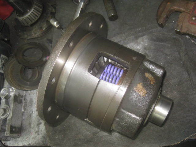

to add pictures it should be as simple as ATTACHMENTS files tab below and ADD FILES will take you to your home computer browser to pick you pictures you want up...??? Y/N?
I did an example picture of a reconditioned Pontiac unit it let me do it just fine...???
