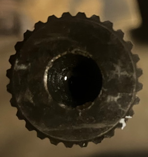

I bought this differential for my 1967 Cutlass Supreme Convertible. The 5.00 gears are too steep for me, even with a 200-4R. From the research i’ve done the 672 carrier has a range of 3.42 to 5.00 and has 31 splines. After disassembly I noticed that the axles are 28 spline. Is this an oddity that Oldsmobile made?

Axle spline: 28

oK, wELL welcome to the site...Hope we can straighten some stuff out for you.
The deal :
672 casting is 31 spline only... Some one has obviously been inside the carrier and swapped out the side gears IF a 28 spline axle fits this carrier.

do the axles (28 spline ) fit the 672 carrier side gear? If so then we know that unit is not correct. should be 31 spline. Worries me that the unit is even set-up correctly or just thrown together??
