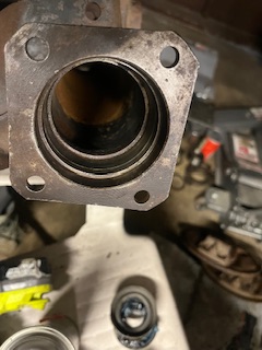

Ok here’s another question. Are these the correct axle bearings and seals? When bolted in they were not flush with the flange and there was no gasket. The flange plates are raised between the bolt holes because of being tightened down and not being flush.

Re: Oldsmobile type ‘O’ 12 bolt question
wELL THERE IS SOME messed UP STUFF GOING ON WITH THAT REAR END...LOL.
tHEY HAVE EARLY AND LATE MODEL AXLE BEARINGS AND SEALS mixed UP WITH THIS REAR. crazy STUFF.
i REALLY CAN NOT TELL FROM THE PICTURES YOU ARE SHOWING ME.
So, if you have a 1970 12 bolt olds the axles will be 28 spline and have OILED axle bearings and the SEALS will be on the axle shaft.
IF you have 1967 - 1969 the 12 bolt olds will have SEALED bearing set up with the seals in the housing tube end. YOURS has BOTH seals ...this CAN NOT BE!
the axle bearing you have on the axle shaft is a oiled bearing and requires oil from the center section of the rear end and the seal they have installed is BLOCKING the oil from the center to the axle bearing.
WE really need to know what housing you have 67 68 69 or 1970?

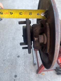

Just pulled the inner seals from the axle flanges.
Seeing that two different sets of axles seals were installed can either set of bearings (sealed or open roller) be used?
There is no code on the inner passenger side tube, driver side also checked, to tell what year or gear ratio.
No Each bearing has a different OD dimension.
sealed bearing has a OD of : 2.7475
Oiled Bearing has a OD of: 2.5591
CAN NOT be interchanged and even the axle shafts are different. The offset of where the bearing land is machined on the axle shaft.
