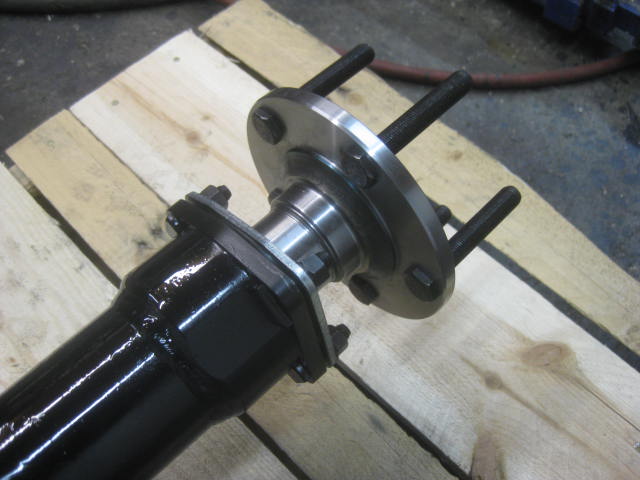

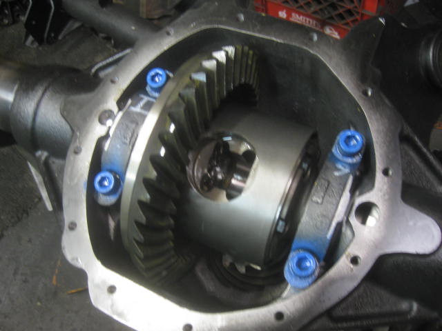

These housings are premo... We use them for all our builds street and race.
Massive Main bearing caps
Machine cap screws larger than stock
Center casting is heavier cast than any GM casting (THICK!)
tubes are 3" OD and 1/4" thick American steel tubing.
ends can be had with any flange pattern you want Ford NEW OLD LArge or small GM small or large all with 3.150 bearing for bolt in axles
(you can get c-clip end too as we use for the street)
we normally go with 33 spline axles for the Chevy 12 bolt
If you have to have bigger axles we recommend a Dana 60 rear...
We have never needed more than 33 for stuff here.
Have to remember the more weight you use for strength the slower the car will go....you need to find just what you need for the quickest vehicle.
We order them all the time and can have it sent to any US port in USA.
Might be easier for us just to build the complete rear??
JD

Re: Buick 1971 10 bolt 8.5 on el camino 1969
pictures of rears
