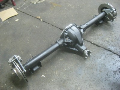

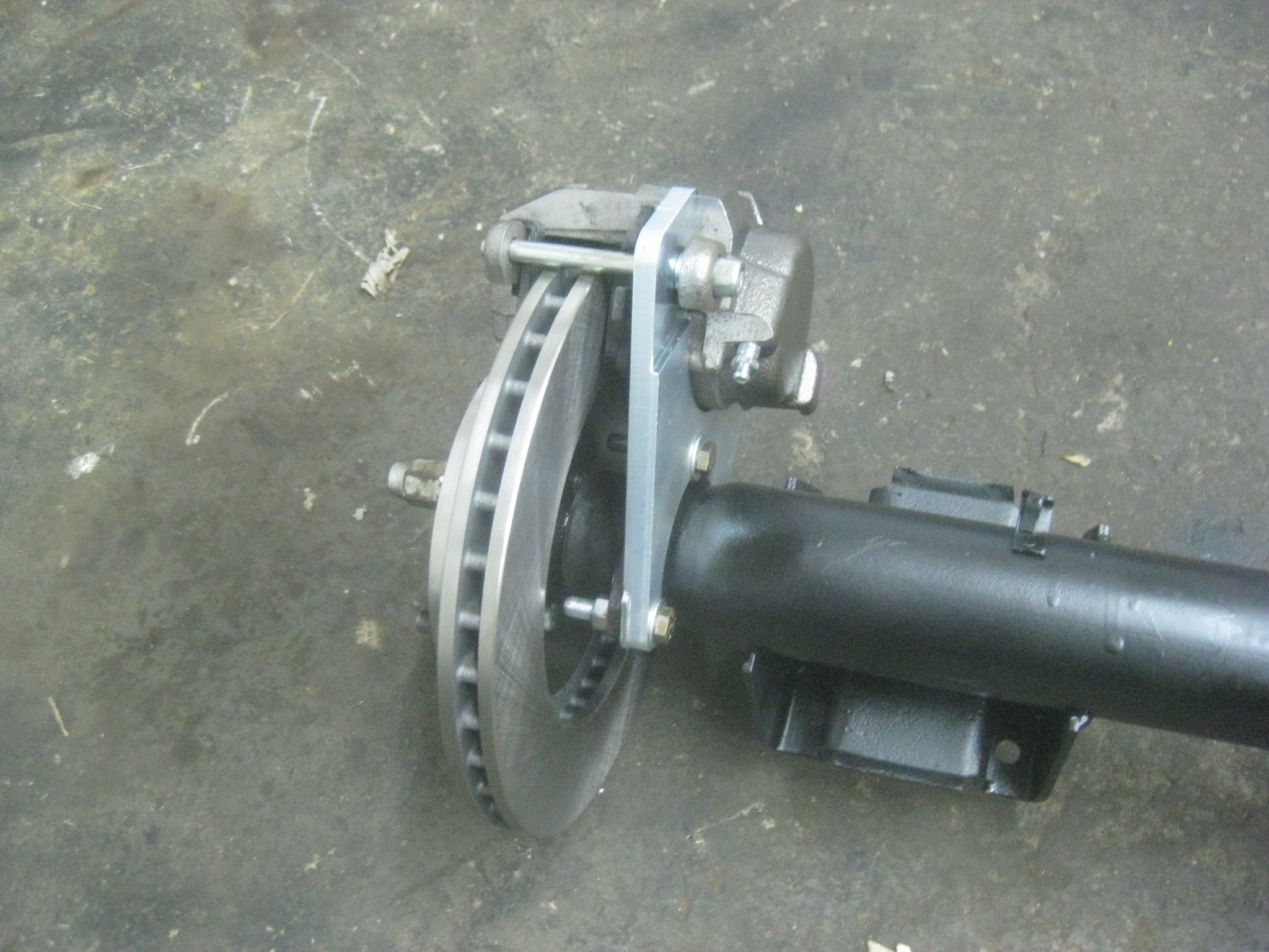

TIP from JD RACE -
If anyone is worried about c-clip axles and breaking an axle - Just install any econo rear disc brake system and that wil lserve as your c-clip elim as even if the axle beaks the rotoe is held in by the caliper which is bolted to the bracket and that rotor is bolted to the axle shaft flange and will not let the axle shaft slide out under any breakage.
So personally I would go to Right stuff detailing ...order up their G-body disc brake econo AFX kits single piston caliper and bolt it on and go have some worry free fun!
Pictures below...You kit will have the metric tower backing plates ...they have the correct kit. 1982 -1994 S-10s can use the same G-body kit for Metric tower flange housing ends too.
Take care, JD Race
