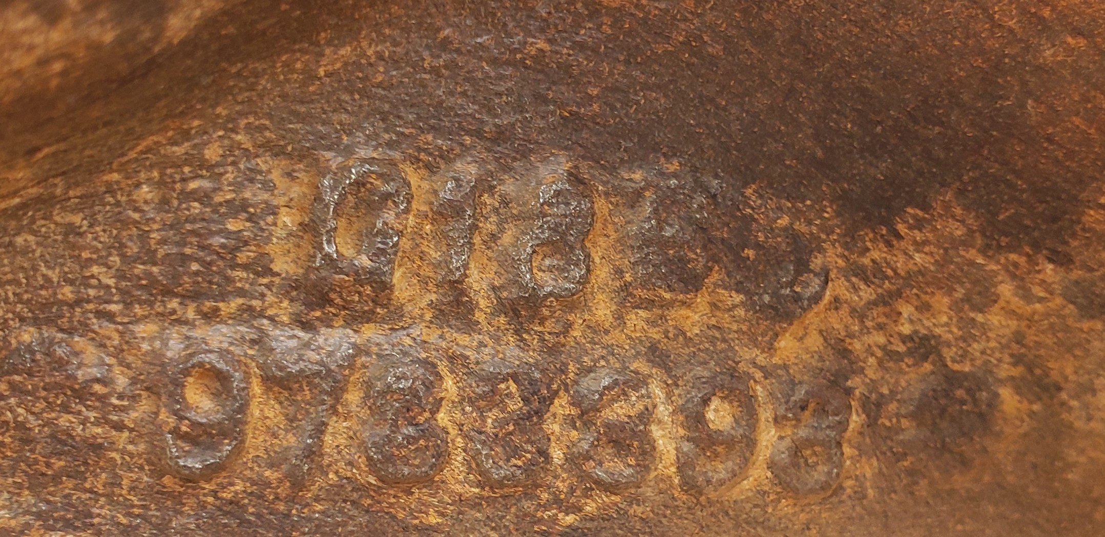

Wondering what I have here.
This came out of a 1966 Lemans. At some point someone put a 1975 - Firebird 350 in it, so I'm not sure what other work has been done.
Looks like a standard BOP 8.2 but I can't find the WD code anywhere in 1966. Inside is an open diff.
Can you tell if this is an 8.2 with 2.93 gears?

WD is a 1967 and newer code. 2.93 Open.... G186 or G188 (G is July 18 is the 18th day and the last digit is year 6 -1966 or 8 - 1968. ) But we always recommend opening the cover and reading the ring gear edge outer diameter to confirm. The ring gear will also be date coded which could possibly help dating this rear.
The rear will be 55.25 from flange to flange or 61" over all.
