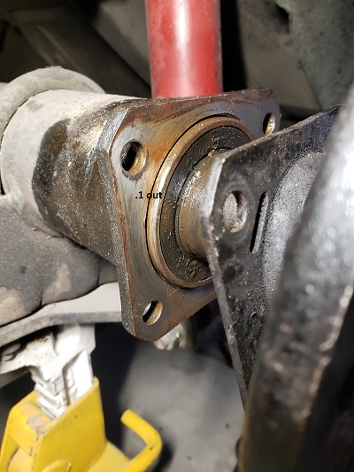

I have a 1968 firebird with a 10 bolt BOP 8.2 differential. I'm preparing for a 4-wheel disc brake conversion. I plan to use Wilwood products. According to Wilwood, a critical measurement would be what they're calling axle offset. This is the distance between the axle housing end flange to the face of the axle when fully seated. They indicate that for the 8.2 BOP this should be 2.75".
When I measure my set up I actually measure 3.1".
When axle fully engaged, the bearing extends from the axle housing approx .1"
Measuring the axle face to the bearing face is 3.0"
The inner race spacer is .6" thick
The bearing is .66 " thick
The axle is 29.75" long
When the axle is fully engaged, it is not bottoming out at the spline end and the bearing/spacer does appear to be fully seated. All the measurements seem to add up. How is it my total off-set is .25" too far extended?

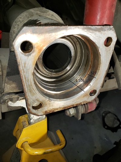

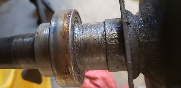

Good to talk to you again today and I really think you've solved my problem. Here's a close up of that bearing surface at the end of the axle. As you suspected, there's an extra machined surface as you move closer to the axle flange. There's another shoulder. I'll get some additional measurements from Wilwood and I'll be ordering those Yukon axles from you tomorrow.

So for everyone reading this.
Jim - has a Oiled bearing BOLT in axle in a sealed bearing rear application.
The offset from the bearing land is 3" on the oiled bearing where the seal is also installed on the axle shaft outboard the bearing keeping the oil in the rear.
What he needs is a sealed bearing axle with the 2.75 offset and the seal is pressed into the housing tube end and no oil gets to the bearing at all.
1964-1969 early are sealed bearings from BOP GM like.
1969 late through 1976 are all oiled bearing axles BOP GM that bolt into the housing....
