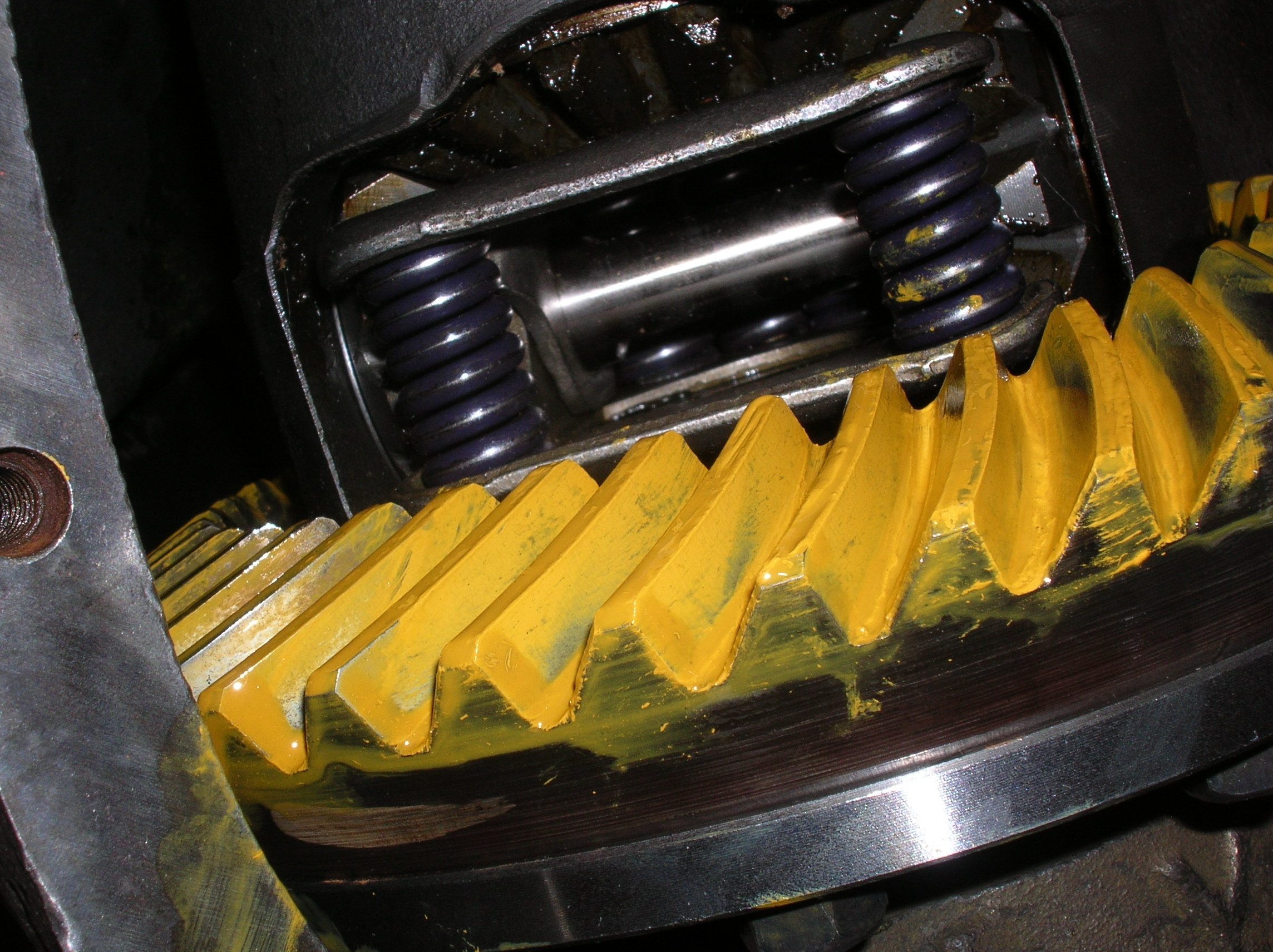

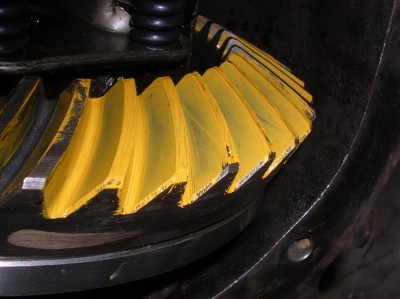

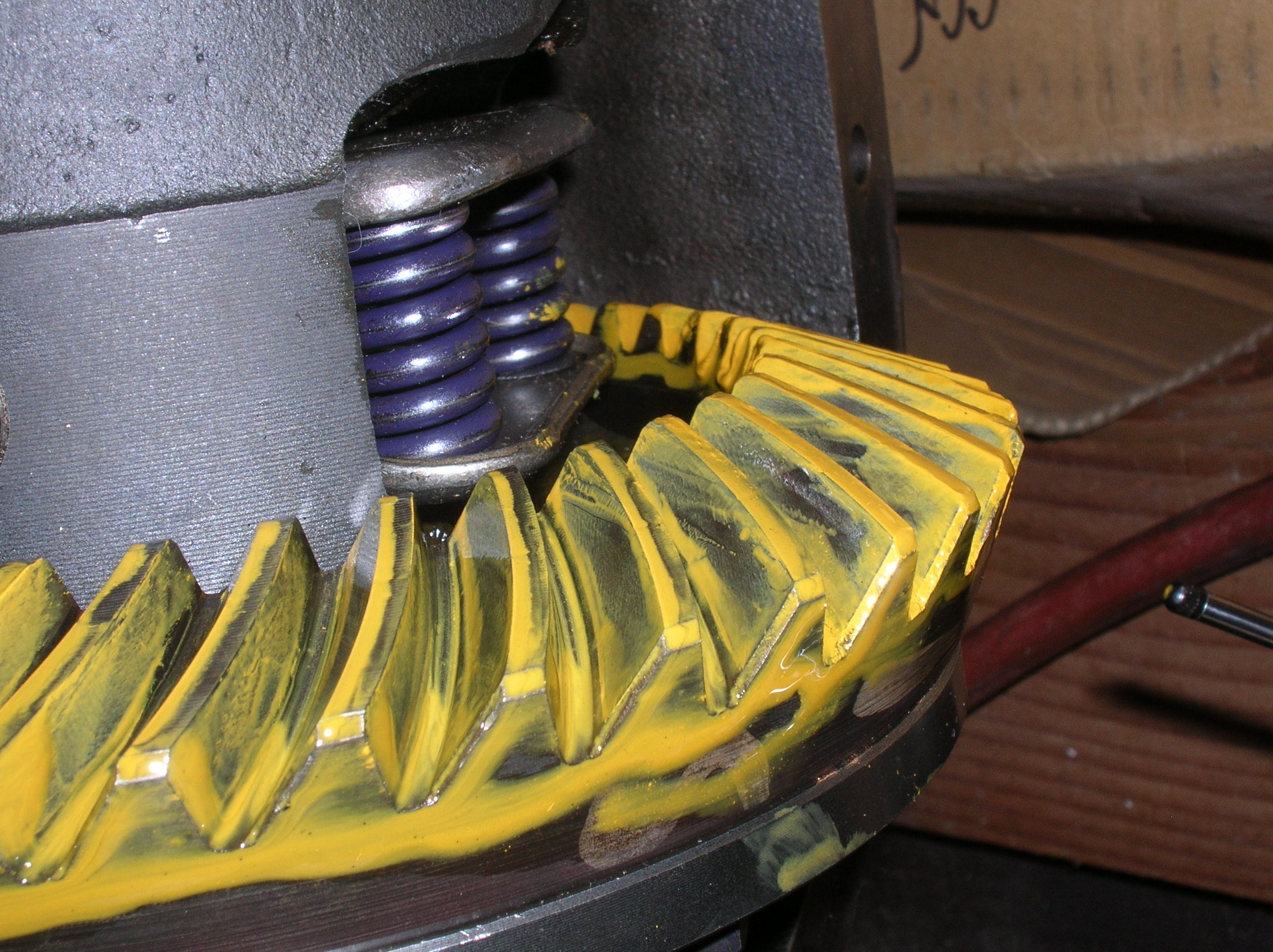

I need some advise on the gear lash.
I'm not getting the nice well defined contact pattern that I see in other posts. Also, is the pattern I am getting acceptable?
Thanks,
Steve
Re: BOP possibilities
Your doing good... A good used pattern will be light like that .... YOUR good just a bit too deep. keep the backlash .008-.010 on used gears.
What is your shim thickness for the pictures just given? looks like a few thousand shallower will do it. take out .002 - .003
That pattern should feel pretty good too as you spin the gear - Jim

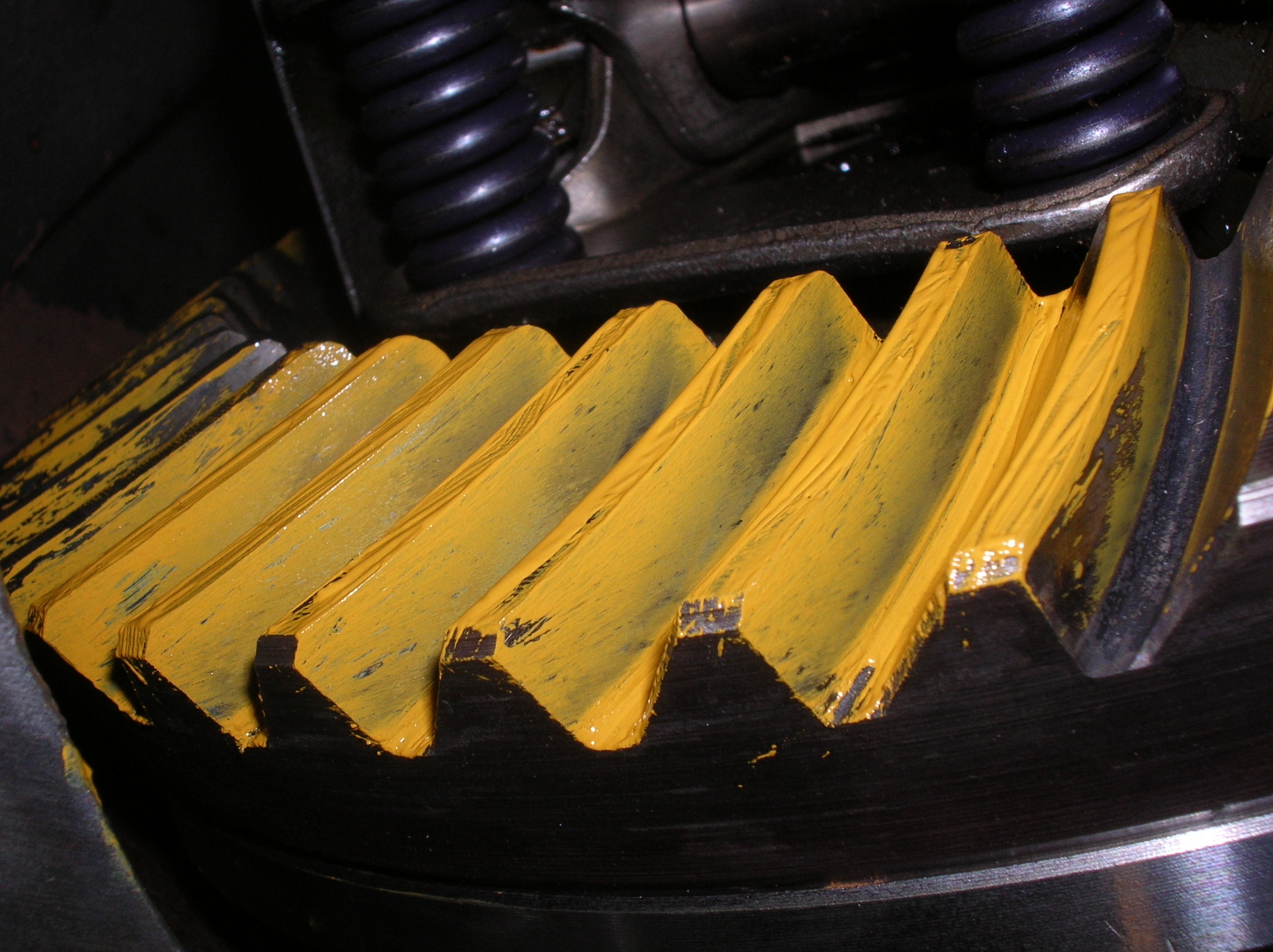

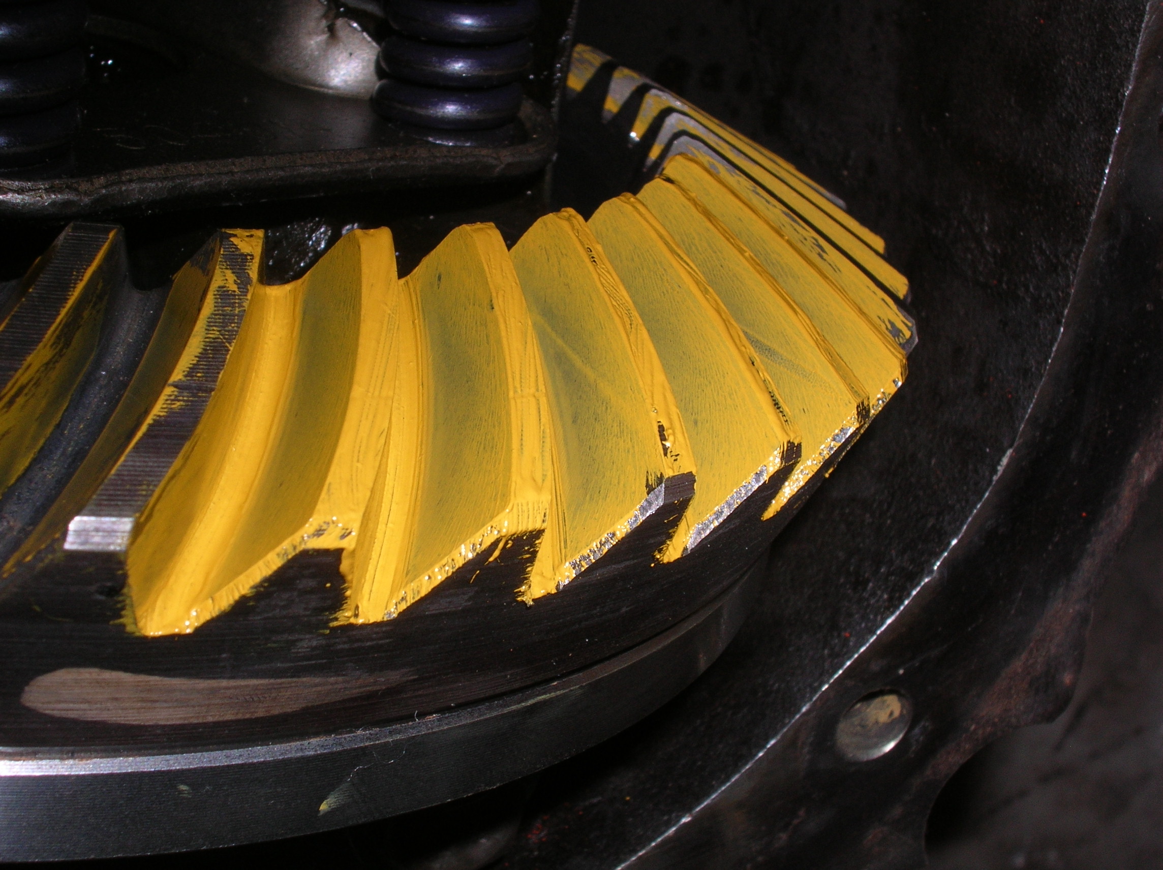

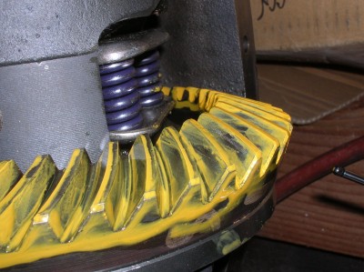

After oiling pics follow:
Coast side seems spot on. Maybe run it and see how it goes. Only thing I worry about is the bearing is old and may have lost some depth meaning if you put on the NEW bearing it may make the pattern go deeper.
Sometimes the installer needs to make the call. If it feels smooth pattern looks good...backlash is good. Run it. Jim
