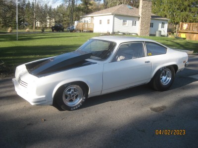

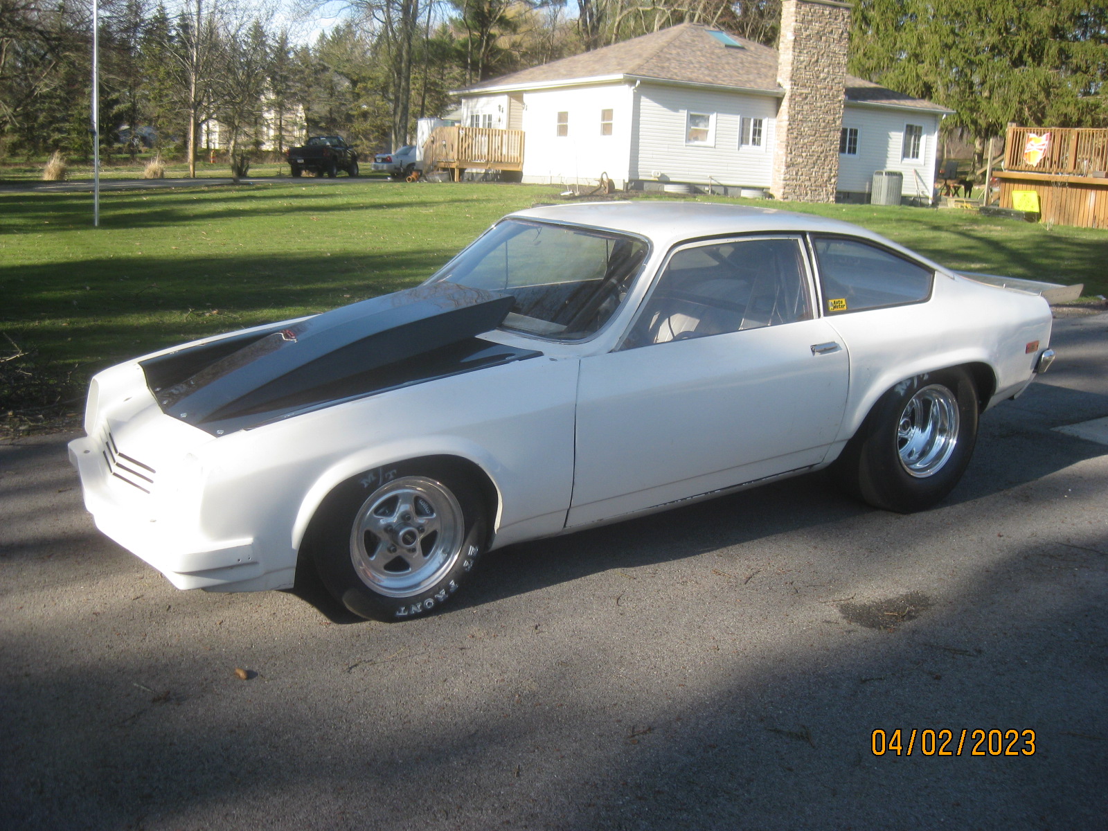

here is her real race car lol. it is 1971 vega back with a fiber glass front 78 clip. chassis car 9.60 at 140mph on 3/4 throttle at this time...shes only 20 years old and does not drive it as much as i would prefer to give her full throttle yet.
