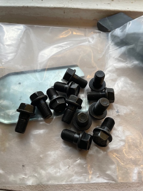

Are the generic ringgear bolts in rebuild kits ok to use? Or should I get ARP.
Re: Ringear bolts
hAVE THEM IN A 9.83 1/4 MILE RACE CAR...sO UNLESS YOU THINK YOUR GOING FASTER WITH MORE TORQUE THAN THAT...uSE THEM. everything IN YOUR KIT WE USE IN ALL OUR builds. We do not have kits that we use then sell another kit to customers.
Yes - make sure you lock tight them...do not need a ton of it...and torque them to 45 - 50 foot lbs.
