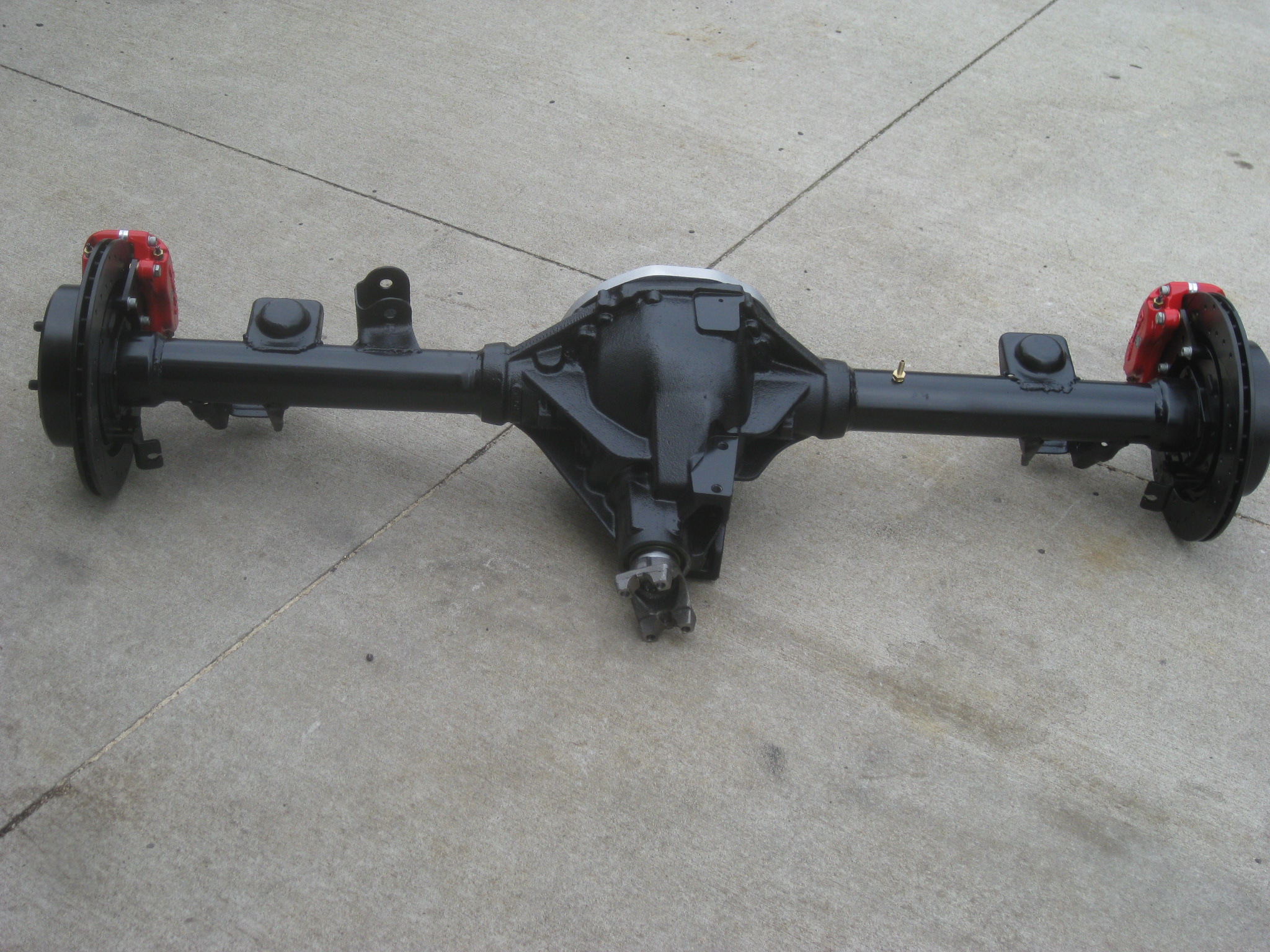

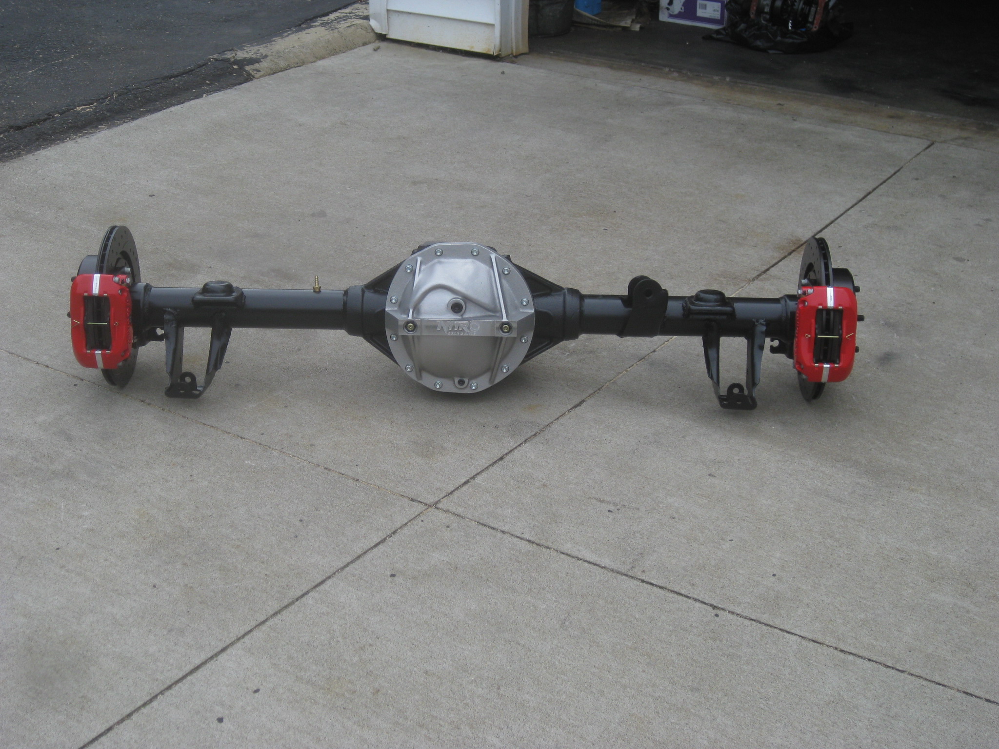

We have done Moser rears 12 bolt for customers but they get pricey. (pictures below.) This one was 3750.00 with wilwood Brakes.
We can use the 12 bolt housing for a camaro and narrow it ...use the monza /vega brackets to create a bolt in monza rear.
