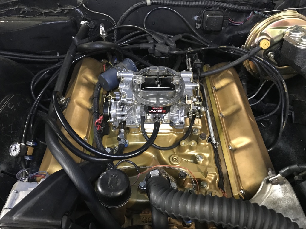

Yes. Frankenstein is alive and runs, i did approx. 600 Miles and now there is something i would like to sort.
Facts First:
Engine: 1964 Oldsmobile 330Cui (Now Bored Up to 350 Cui)
Heads: Olds 7A (1972 / 64cc)
Compression: 10.66 : 1
Pistons: Seald Power L2320F
Lifters: Elgin Hydraulic Flat Tappet Lifters
Push Rods: Comp Cams
Cam Specs: Dur@050 Int.224 / Exh 236, Lift Int. 504 / Exh. 512, 112 Lobe Separation, 45 Degree BANK ANGLE
Carburetor: Edelbrock AVS2 (1906) 650 CFM (+ Tuning Additional 0.04" Holes on all 4 Throttle Pates)
Intake: Edelbrock 2711 (Olds 350 Performer) + 1 x Adapter Plate
Vaccum Canister: by Comp Cams
Power Breaks with Dual Master Cylinder (all 4 Wheels / Drum Brakes)
Rockers: Harland Sharp Rockers (S50062A)
Lifters: Elgin HL1951S Hydraulic Lifters
Exhaustmainfolds: Thornton's Small Block JR Exhaust Manifolds
Exhaust: 2x 2.5" Dual (Left & Right/ No X-Pipe)
Transmission: TH350 Heavy Duty Build (Alto Parts, + Shift Kit)
Torque Converter: Assault Racing 3200 - 3500 Stall (Boss Hog)
Vehicle Weight: 1424 Kg / 3140 lbs
Rear End: 1964 Oldsmobile Cutlass, Typ: P 3.08 (3.08 Ratio)
Tire Size: 205 / 70 – R14

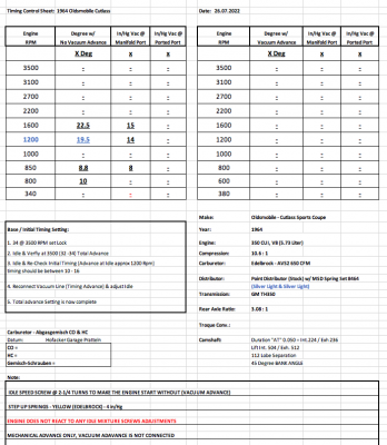

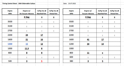

Timing:
I got the timing Set as following.
Base Timing (Setting without Vaccum Advance): 15 Degree @ 1200 RPM
If i connect the Vacuum (Point Distributor), i have 34 Degree @ 1200 Rpm
Problem:
My problem is that i have a Idle Drop from approx 1000 Rpm Idle
to 400. It not possible to adjust the Idle (with Vacuum Advance Connected)
between 1000 Rpm and 400 Rpm. i would love to have approx. 700 Rpm in Gear at a stop light.
Any input why or what i could do?
- Wrong Timing Advance?
- I have the Engine knocking under Load with 18 Degree @ 1200 Rpm (Base Timing) so more Advance aint the way.
As i didn`t had a Cam Card for the Camshaft (only a small Sticker on the Box), i set the Timing Chain to 0 Degree durring installation
and i didnt "Degree" anything.
Question:

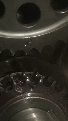

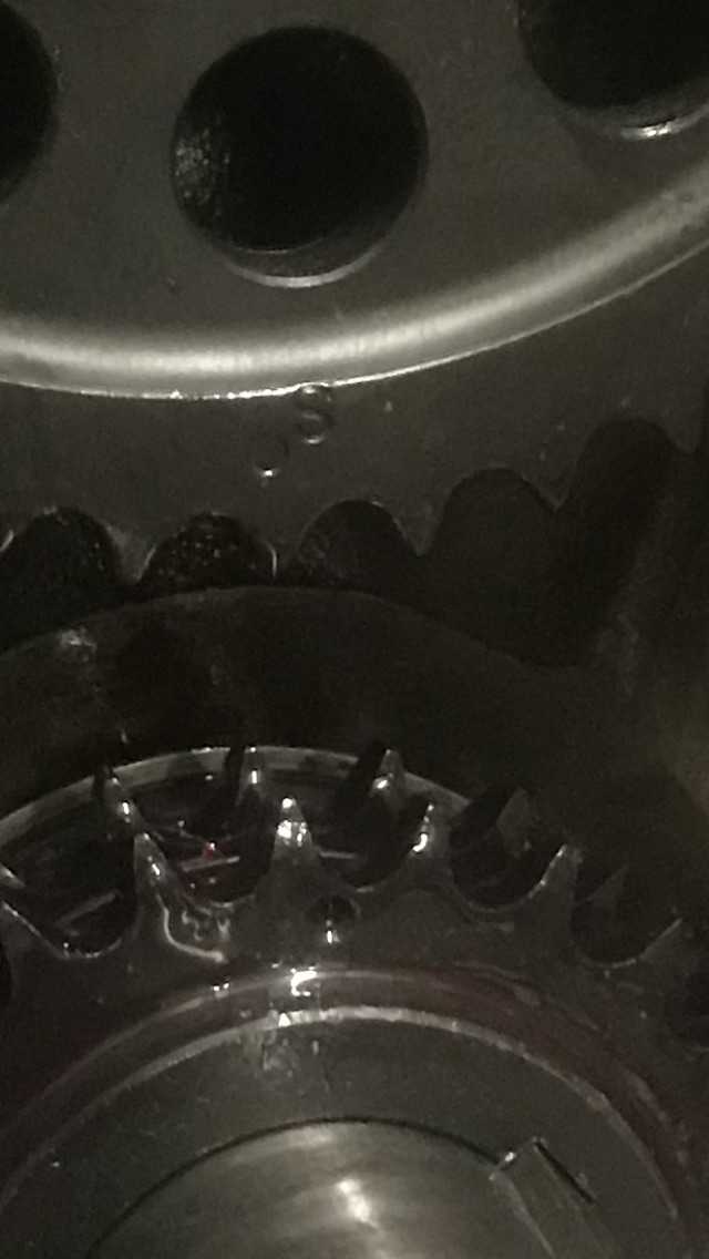

Can i check if the Timing Gears / Chain degreeing is wrong if i go on TDC and use Air pressure thru Sparkplug of Cylinder Nr.1 with a valve Lifter Air Tool.
If the Pressure doesn`t build up (or stays) on TDC the valves aint closed, so i could turn the Crankshaft (BTDC o ATDC) and read the degree from the Balancer Scale. Right or totally wrong? So this would be the amount of Degree that would need to be Advanced or Retarded at the Timing Chain.
or could it be the additional holes on the Butterflys of the Edelbrock AVS2 (1906) 650 CFM (+ Tuning Additional 0.04" Holes on all 4 Throttle Pates)
Thanks for all your help
Greetings
Nic

Re: 1964 Cutlass "Frankenstein Build" is Alive but Idle drops with Custom Cam
Nic, Wow... sorry to hear your having a headache.
Well we see what we can uncover here.
First thing we noticed which is CRAZY most important thing in any motor is the distributor....
What are you running?
You have absolutely no info on this item in your thread.
Another thing is WHERE do you have your vacuum advance hooked up.
Vacuum advance is usually for engines that you want fuel mileage...
Most all our street vehicles that are built up only run mechanical advance. NO VAC ADVANCE.
we run the 6al box and MSD on just about every one of the street vehicles too.
Timing sounds fine 10-15 on the balancer at idle RPM to us sounds high 700- 1000 should be enough.
When you hook the vac advance the RPM will go up and your advance will too NOT IN GEAR
I do not understand the drill holes in the carb plates. For the set up you have you still should not need those in a carb. That is leaning out the idle and will cause you to fatten up the idle screws and a reason the car can not idle at lower rpm (likely)
Duration on the cam is just not that big to necessitate that drill option...that is for radical race cars.
So on the distributor... pull the cap and rotor and send a picture of the advance weights and springs for us here.
Lets get that info before doing anything to timing and taking anything apart...

This is how i set Base Timing with a New Distributor.
1. 34 @ 3500 RPM & Set Lock Stud.
2. Idle down & Verfiy at 3500 (32 -34) Total Advance.
3. Idle again & Re-Check Initial Timing (Advance at approx 1200 Rpm). The Timing should be between 10 - 16 Degree BTDC.
4. Reconnect Vacuum Advance & Line with the Ported Vac. Plug of the Distributor (Timing Advance) & adjust Idle to apprix 800 - 600 Rpm
5. Total advance Setting is now complete!
When i did the Engine i got a Speedmaster PCE264.1016 Timing Chain
i didn`t gamble with any Retard or Advance settings. I set the "S" mark on the Camshaft Gear with the "dot" mark of the Crankshaft Gear.
now lets hope that Speedmaster Set, Crankshaft or the new Camshaft is not "Off" in any degree..
Yesterday 23rd of July i closed the 1.5mm holes on Primary Throttle Plates. The two 1mm Holes on the Secondary Plates are still.
About Idle Fuel Mixture, I have a "Emission Control Maschine" with %Vol CO & ppmVol. HC.
I adjusted the «idle» mix with approx. 4 %Vol CO on both sides but i can not remember the "ppm Vol. HC" value.
Its a fight to get any measurements with a connected VAC Adv. on Ported Plug of the Carb. between 1200 Rpm and Lower.. the Engine / Carb is so sensitive if adjusting Idle RPMs.
its like 1200 RPM solid or 380RPM chopping Solid.. all between is a random to have it solid.
I never had this in the beginning (during Engine Break-In Phase, first 600Miles)
Maybe somewhere around the Vac. Advance of the Distributor, Springs, Leak, damaged ?

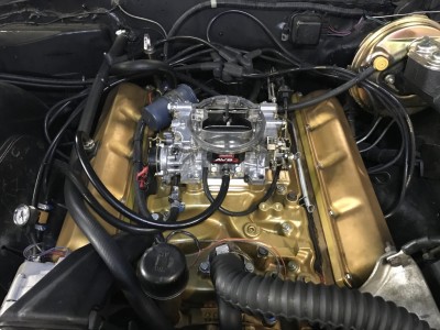

and here some more visuals
Nic_SwissCutlassDude
- Rookie Poster
- Posts: 13
- Joined: Tue May 03, 2022 2:59 am
- Location: Basel Switzerland
Ok things I see.
Carb primary throttle blades...open WAY too much in the picture for idle.
Engine - vacuum line to valve cover...is it one way valve? also do you really need that? We just put open breathers - do you have emmision checks in your area? try to plug that vacuum line to valve cover for now and see if you get a change too.
Were trying to find the draw here that is making your engine have to idle at too high of RPM. USUALLY a vacuum issue.
throttle spring- please find a dual throttle spring for your carb. Safety sake and also it will help your throttle not have soo much tug on the pedal... nicer for driving...
Distributor - advance springs. dump those springs unless your looking for terminal gas mileage. THEy need to be lighter. This will likely have NOTHING to do with idle...just launch and how fast your car will advance and ramp up to full advance for high performance stuff like burn outs and acceleration.
Points- Yah we really need to upgrade that...BUT do not throw that distributor away as if the SUN starts throw solar flares etc...points can be very useful...lol.
Have you played with the dwell on the points?
Vacuum advance.... Just dump it for now and tune the car with out vac advance...LIKE it will never be used. See if you can get it to idle that way and drive good and strong. You said your getting another distributor...it might be the pod playing games or the port in the carb just not playing with the throttle blade holes you have and the throttle slot being over exposed in the picture.
Remember I can only guess from here I am not there hearing and playing.
Trying to help the best I can from a distance. Bear with me.
do not take offense to anything... remember this is your car and you can do what you want and try what you want. I am here to throw an extra set of eye and ears on the project.
- Rookie Poster
- Posts: 13
Ok things I see.
- yes its WAY open maybe cause i needed that power to hold the Engine or cause of the Warm Up / Choke throttle adjustment Stud.
Yes its has a steel ball in it, i think under higher Vacuum it will suck it upwards and get unburned Gas back in.
i don`t need it, i just rebuild it like the original engine had it. on all other cars i have breathers.
Yes we have. max 4.5 %CO thill 1983 Cars.
i will do that again. but i don`t think was a big deal as far i remember that.
yes.. thank you so much.. i thing its something between "Distributor, Vacuum Adv. Can, springs, and things"
i think i need something that the Vacuum Adv. Can don`t react under 8 In/Hg (different Vac. Can?) or that the Vac Ad. doesn`t jump in under 1000RPM. (tougher springs?)
i think the timing & RPM adjustments & readings are by FAR easier without connected VAC Advance.. so i will drive it tomorrow without connected VAC Adv. and see how pure mechanical Advance is to drive.
do you mean a Thottle Return "pulling" spring?
if so.. i really thought about that.. "if these horses can`t return.. your done" it happend once with my 1978 Cutlass..
Uff.. okay.. i thought i need much Stonger to sort that RPM vs Vac Adance struggle.
i have a MSD spings kit somewhere.. so i go softer.
I`m a keeper.. hahahaha shi**
never! i just keep the newest part of the old engine and swapped it into this new engine.. its a refurbished "AUTOLINE D243"
yes i will test and let you know!
do you think a MSD Dist. Part # 8529 is a good way to go? its very expensive if i calculate shipping & Taxes etc. on top..
it looks like there a few good options to make adjustments if needed.
of corse! and i`m sooo glad & happy for different inputs, help or point of views..
Finally.. about Total Timing.
should i rev 3500Rpm w/ 32-34 Degree or 3000 Rpm w/ 32-34 Degree ? is it about that type of Camshaft?
Thanks & i will come with updates.

Okay, Todays Journey was as following.
I went to the Car and reset the Edelbrock AVS 2 Carburetor to «Lets say, out oft he Box Settings». I took of all Vacuum user from the Car band closed these ports.
(Vacuum Advance, PCV, Manifold Vacuum)
So i turned the Idle Mix Screws (Left & Right) clockwise back in till Stop and then 2 Turns Out again for the beginning.
I did the same with the Idle Speed Screw.
I Turned that Screw «outward» till the end of the Screws Tip barely touches the Throttleplate Linkage and checked aswell if the «Fast Idle Linkage» is not holding the Throttleplates open.
Then i Turned the Idle Speed Screw 1 Turn In.
I changed the Distributor Springs to the Lightes possible setting (MSD Springs - Silver Light & Silver Light)
Then i gave it the first try and i could not start the Engine with the «Idle Speed Screw - 1 Turn» . So i tweaked the «Idle Speed Screw for 1 more turn = 2 Turns Total»
I Started the Engine and it was on the Edge of holding on. So i gave it a little ¼ Turn more on the «Idle Speed Screw = Total 2 ¼ Turns» and it Startet and kept holding on, on a very very low of 380 RPM.
1st. Fact - The Car did not Start & Hold under 2 ¼ Turns of Idle Speed Screw.
So to get a bit more RPM i needed again more «Idle Speed Screw Turns» .
At around 850 RPM i was checking if some Idle Mixture Screwings would help me now.. But there was nothing, No reaction of The Engine or Vacuum. I turned them «Inwards» till Stop and the engine was still running with no signs of anything. I turned them Out again, each up till 4 Turns.. Nothing...
2nd Fact - Idle Mixture Screws don`t react at 2 ¼ to 3 Turns of Idle Speed Screw Turns anymore. Cause of the exposed Transfer Slots by the Primary Throttle Pates.
3rd Fact – Not possible to adjust a solid Idle.
So i took the Carburetor off and checked the Primary Throttleplates set with (2 ¼ Turns) by far to wide open! Then i opend the Carburetor to check all 4 Jets, Rods, Step Up Springs, Pump & Re-Adjusted the Floater Levels and cleaned it.
I put it back on the engine again.. and there was no change.
Question:
what causes this problem that i can not get the Engine running without «Bypassing» the Idle System with approx. 3 Turns of the Idle Speed Screw.
- Carburetor Damaged?
- More Advance Timing? False Timing
Thanks for your Inputs!
avs2 1906 carb is a square bore carb...YOUR picture is a spread bore carb....??? So what carb do you really have?
They are calling this carb on summit site a SQUARE bore...BUT it is not it has front primaries smaller than the secondaries...THIS IS A spread bore carb. BUT that really is a moot point in the trouble your having...I am just trying to look up specs on the carb you are using. Jim
