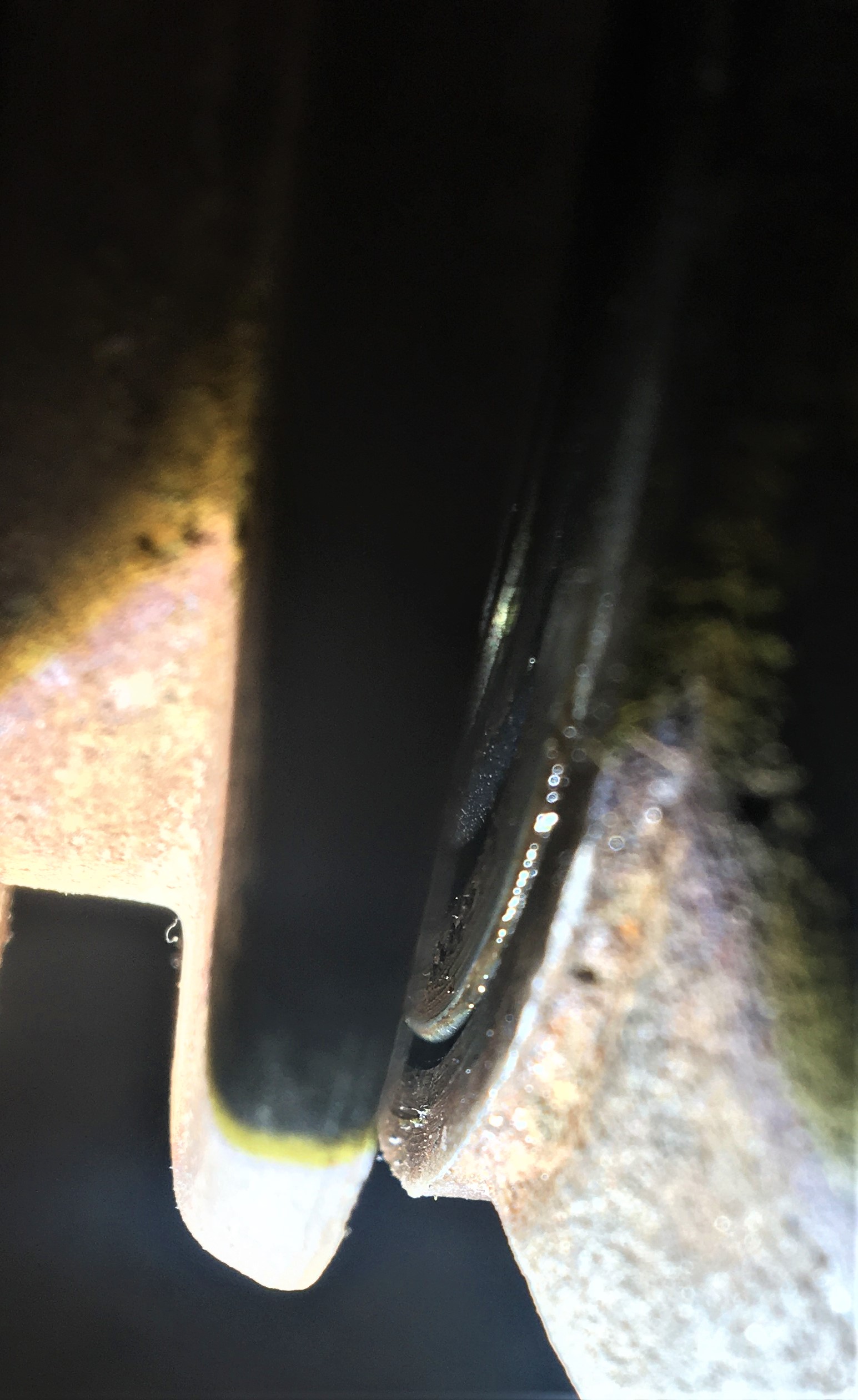

I will post an update here as soon as they get back to me. If they fail we will go into it deeper. The only pic I took before taking it back to them is this pic of what appears to be it leaking from between the shell of the seal and the housing on the driver side. Maybe I am wrong but it sure looks like that and it isn't wet on any other area of the outside of the seal accept for where it ran down to the bottom of the housing and dripped on the floor.

That is why we ALWAYS always use RTV on the OD of the seal metal surface that meets the housing ID surface. There might be a screw driver pry scrap in your housing casting where the seal meets the housing casting machined surface. WE run into this alot. BACK yard mechanic screw driver pry bar issue...LOL. :) Jim

monzaz wrote: Fri May 20, 2022 7:53 pm That is why we ALWAYS always use RTV on the OD of the seal metal surface that meets the housing ID surface. There might be a screw driver pry scrap in your housing casting where the seal meets the housing casting machined surface. WE run into this alot. BACK yard mechanic screw driver pry bar issue...LOL. :) Jim
When I disassembled the rear before dropping it off at the rebuilder the first time, I saw marks just like you describe on the inside of the housing where the seal goes,as if someone at one time jammed a screwdriver in between the seal shell and housing to pry the seal out.
I didn't think much of it because they were not deep, couldn't even catch a finger nail on them. I didn't even smooth them over with some crocus cloth which is what I should have at least done.
Maybe this is the leak source, I hope so as it should be an easy fix. Have not heard back from the shop yet in the three days since I dropped it off.
Re: Pinion seal leak
As stated. RTV black silicone on the outer edge of the seal then tap it into the housing... IT WILL stop that score leak. :)
