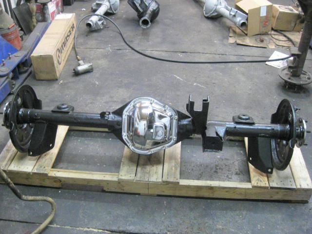

WE are trying to make our own 14 bolt custom full size car rear here...Just have not had the time to spend on designing the upper control arm ears needed to use the 9.5 14 bolt truck rears we have been collecting.
Pictured is a Dana 60 Riviera 1968 rear we did
