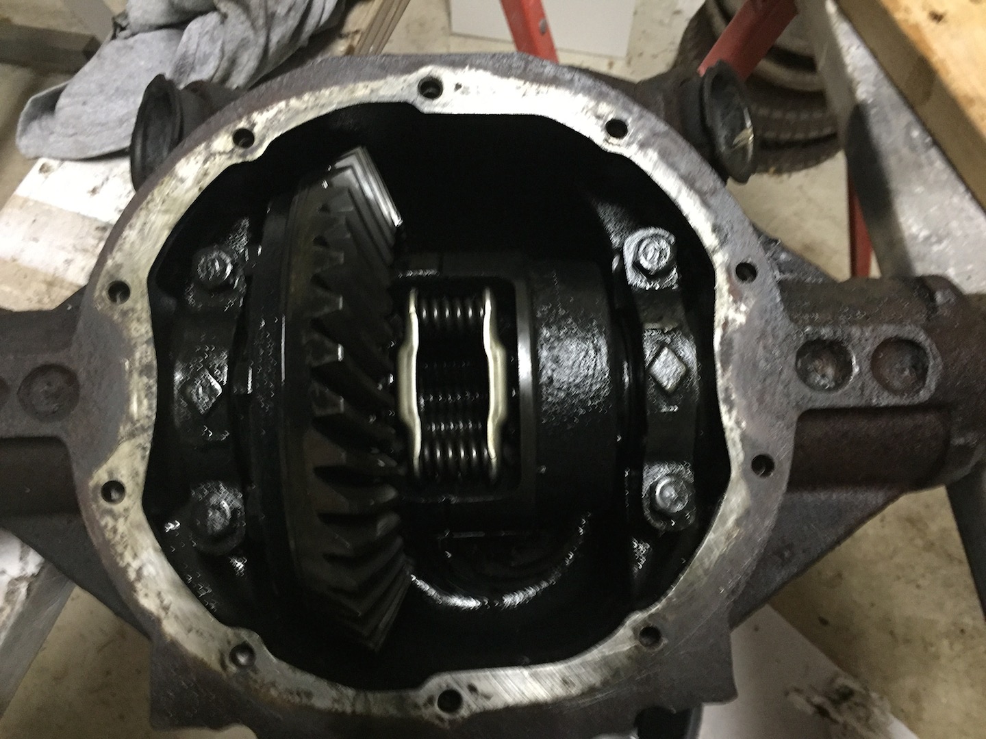

My axle length is 29-1/4" on the bearing side and 29-5/8" on the wheel side of the flange. I have included a pic of my limited slip unit as you requested. I really cannot afford custom axles so I'm hoping there is an aftermarket stock answer you can sell me. I'm wondering if the '72 Chevelle axles are the same size? I really appreciate your reponses.

The posi you have is a factory GM Borg warmer unit. What ratio is on the posi carrier? Egde of the ring should have stamped numbers on its most outer diameter of the ring. Keep spinning till you find them.

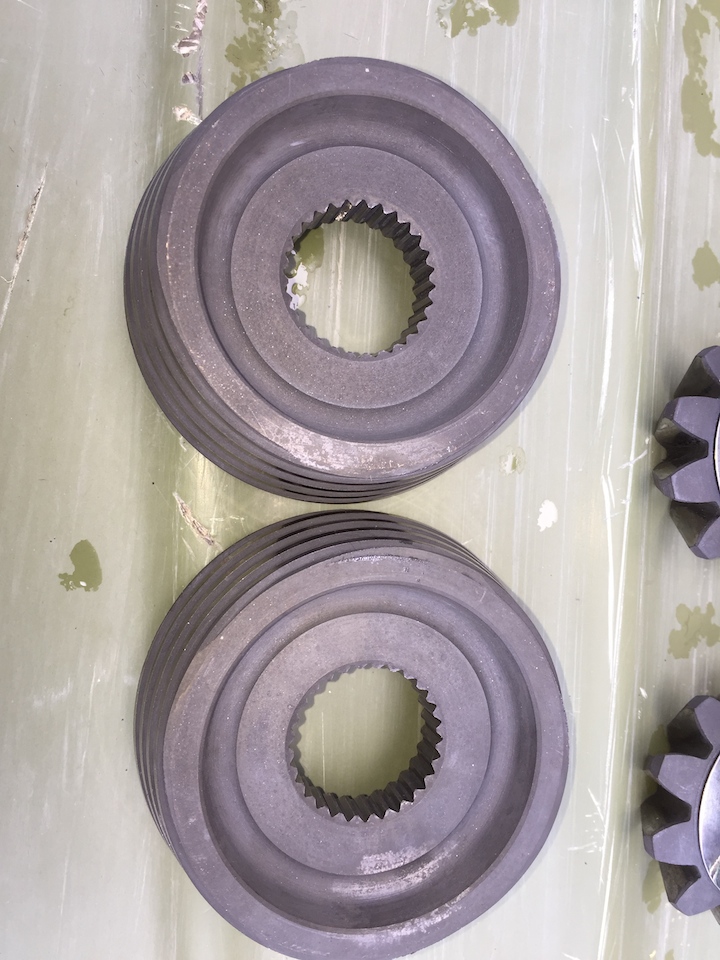

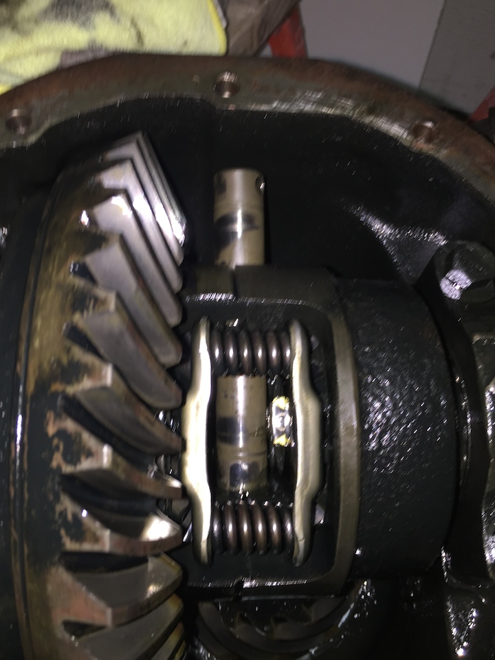

I got the posi apart. One cone surface is galled, the flat surface between the spider gear and cone looks really rough and the inside teeth of the spider gears look a bit worn. They are definitely not as sharp as the inside cone teeth.
Re: Cutlass 8.5 Axles
Well the pictures you gave are not what I need. :) Need the bottom of the cone and the spider gears ..That galling do not worry about ... That is because of dirty oil and heat and debris getting smashed in between them. More pictures...parts pictures are better when not cleaned and just as is when removed for inspection

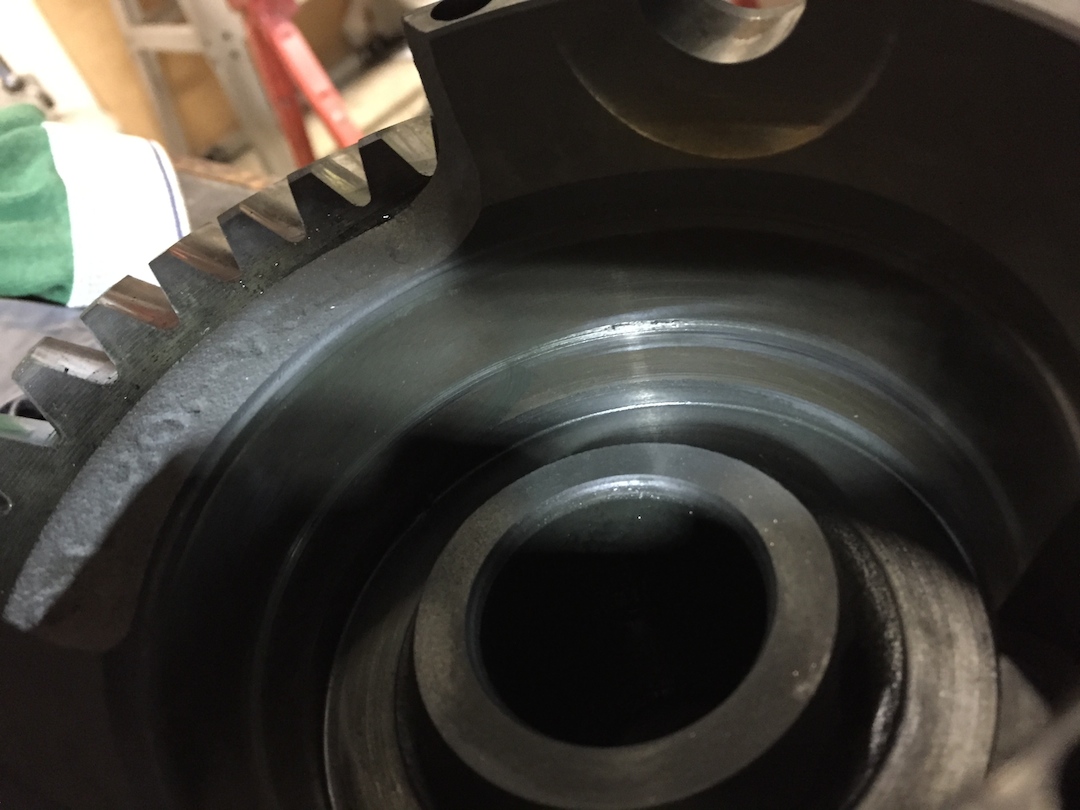

The bottom of the cones have no wear. They look new on the ends. The spider gears are in good shape as well. My concern was the odd looking wear between the cone and side gear. There was NO washer between either set. The previous picture shows what I'm talking about. If that is not a problem I would assume the only thing that would really need replacing is both side gears. Of course, this is the first posi I've torn into so I know next to zilch. Thanks for any help you can give. Mike
