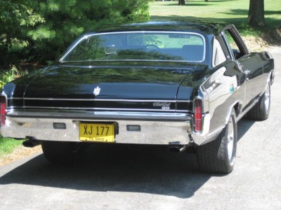

I have a Chevy 1971 Monte carlo with 4.5 x 8' backspacing 295 50 15" wheels 12" wide tires. Stock width rear as the car came with...PLUS the Monte has a almost fender skirt rear quarter area. Jim
