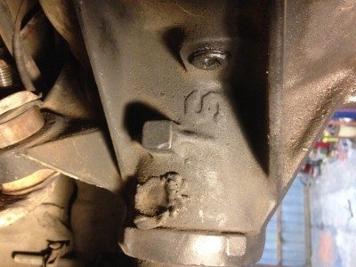

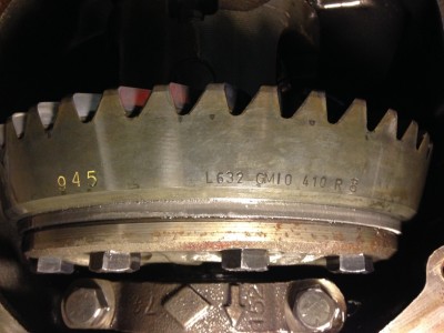

Hi! I have a 72 Chevelle, small block SS VIN, and it has a 454, with a ten bold rear end with 410 gears. The rear end does not seem to fit well in the car. It looks like i will have to shorten the upper trailing arms to 9-1/8 inches to get the pinion rolled down to get good driveline alignment. I've been having trouble identifying the axle but now see some Olds pictures which seem to match. Casting number 1235198. Ring gear has what looks like left hand bolts with 5/8" heads. There is a large raised S on the front of each side of the casting. Is it reasonable that this was not a direct bolt in for a Chevelle?

Need to see the rear end panned out mounted. That mightr be a 73-77 rear under the car which has the upper control arms in a totally different angle and the lower arms may also be an issue if they did not change them to the correct spots also.
J D
Or get us a casting number from the center section casting.

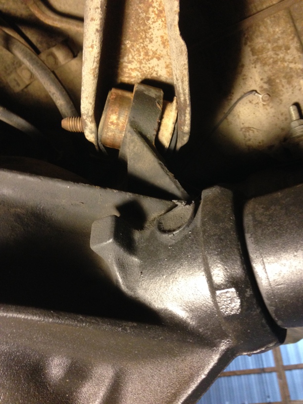

Casting number for the pumpkin was in my post, 1235198. I can't find it referenced anywhere. Lower arms are boxed, but it looks like the axle has had no modifications, and things don't seem to fit. The symptom was a broken transmission tailshaft housing. I don't know if the excessive rear u-joint angle (about 7 degrees up while the front u-joint angle was 1-12 degrees down) would have caused that during tire spin, but I had just replaced the bearing and seal while changing the shaft gear to correct the speedometer. I sure appreciate your help. I'll try to get a wide shot from underneath, the lower arm bushing look ok each end, the upper bushings are stressed in the original 7 degree angle (picture) and are way off when I get the axle rolled into where it needs to be.

OK, got a few more pictures, hope these help. The axle is oriented so the pinion angle is right in these photos. The upper arms are disconnected from the axle only, so you can see the alignment offset. The lower arms seem to fit pretty good, to me.

The rear is a 1973-1977 era a-body. NOT EVEN close to the right rear in your car. You will never get thaT THING IN CORRECTLY AND IT IS ALSO ANOTHER INCH WIDER THAT THE 68-72 REARS. AND 2" WIDER THAN THE 64-66 rears... So you will have al kinds of issues with that set-up. Sorry . Jim

You can use all the guts IF you find another 10 bolt 8.5 from a 1971 1972 Cutlass or Skylark. IT CAN NOT BE a rear from the 1973-1977 era.
