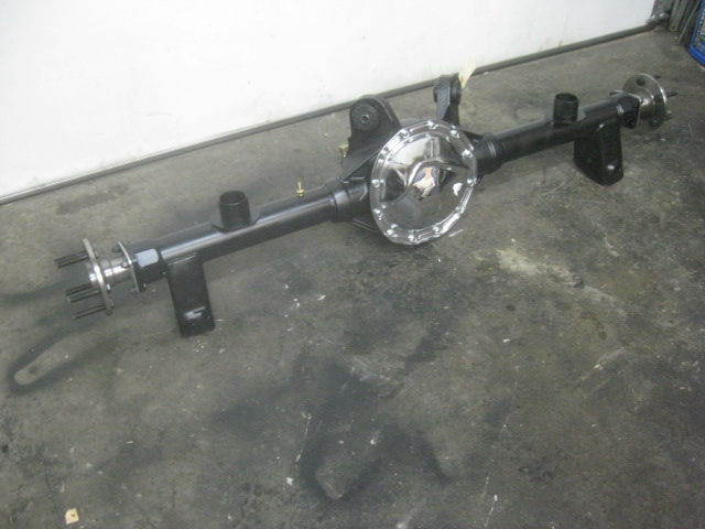

We build totally custom housings to fit the g-body chassis...BUT we have been so busy we have not build one this year.
We can do Moser Housing 12 bolt build and install our guts to make you a very good strong bolt in 12 bolt Chevy rear with all stock control arms Just PM us.
