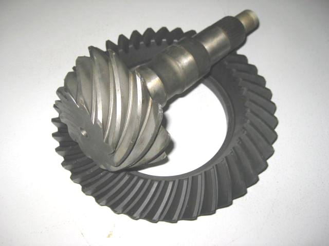

Yes, we have the parts and the rear shold be a 10 bolt 8.5 corporate GM rear.
carrier break is 2.41-2.56 2 series
carrier break is 2.73 - 5.57 3 series
Ring diameter is 8.5" (outer ring gear edge furthest points)
Pinion spline is 30
Pinion shaft is 1.625 diameter.
tooth count for 3.23 will be 13 pinion and 42 ring divide and you get 3.2307692 or rounded 3.23 ratio
We have sent you a pay pal money request for the gears you need.
Thank you, Jim Mitschke
