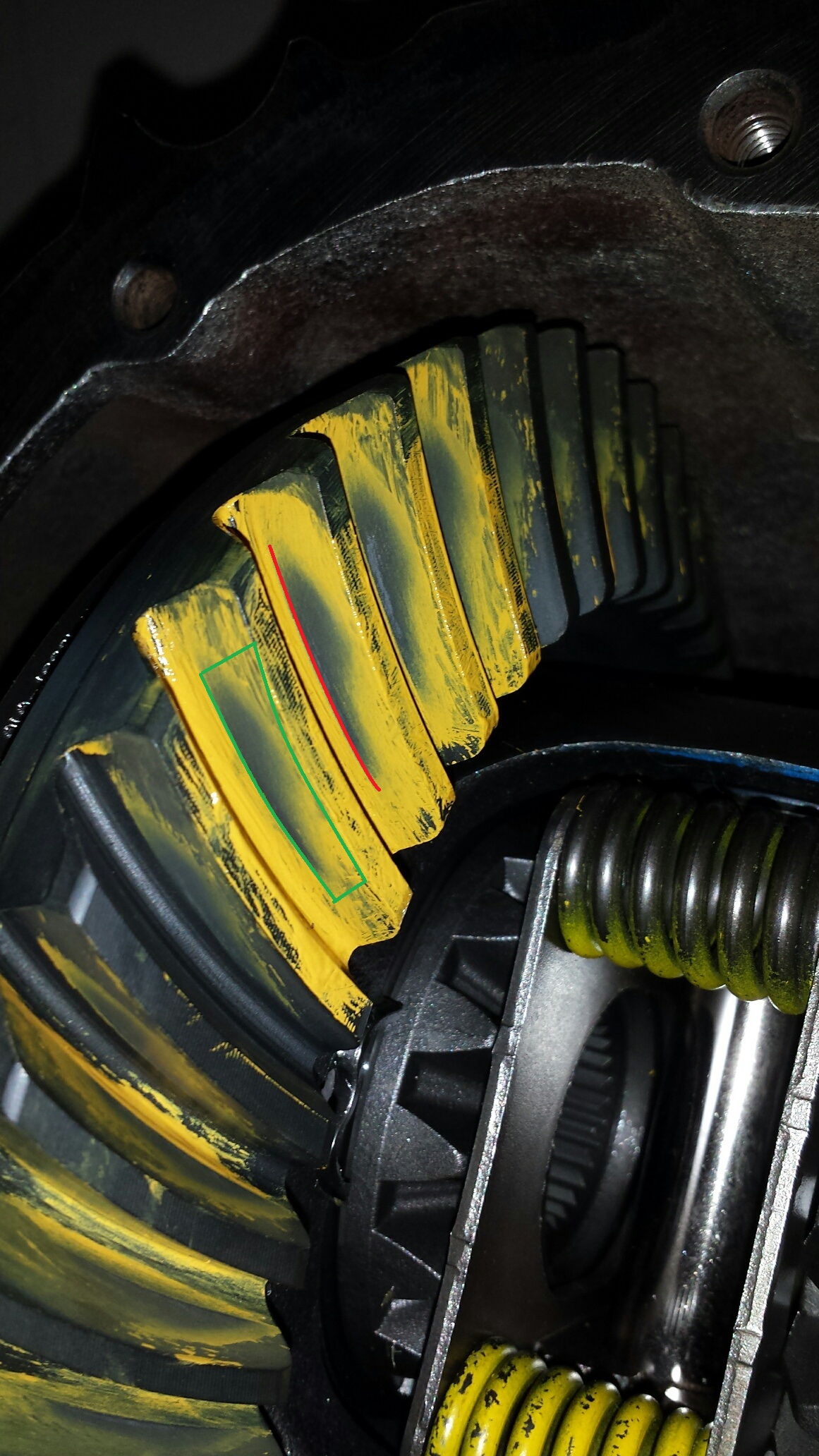

this is what i started with, 8.5 rear, eaton posi, richmond 3.23 ring and pinion, install kit from JDRACE.
old pinion inner bearing honed out with 052 shim,preload of 14in.lb.
244 pass. side carrier shim, 221 drive
.001 ring gear runout
backlash checked at 90deg. poss. .006 .008, .008, .005
takes slight pop of prybar to dislodge carrier
i think it looks good, but i need your opinion!

Way too deep. go yo .040 .038 and try that. Jim

open up the backlash to about .010 see how that looks. Jim

the red is trouble - the green is where you want your pattern to swipe. Jim

had it at 038 and was riding on top edge, will try about 045 and get backlash to 010

ok, today i got this with .041 pinion shim
.080-.010 backlash

it is definitely better... How does it feel spinning it? Smooth on both sides coast and drive with equal drag?
Throw some oil on it and see how the pattern looks after that ? Might be a hair too deep but it will definitely not blow up or fall apart etc. Could be a runner. :)
Now you have to get your pinion preload set. One more double check on the pattern and you will be finished. Jim

Do you see how the pattern moved? from the root to the middle of the tooth? As torque is applied to the gear face it will spread across the gear teeth faces.... you will see after your first oil change at 500-1000 miles. If you keep going with removing shim it will start to climb up the tooth to the peak if the tooth showing it is too shallow. Now there are many different good patterns but you always want to swipe as much of the gear from top to bottom and toe to heel second. Try to always keep the pattern equal on each side of the gear from coast to drive as you can... Sometimes reading the pattern can be a bout tedious after hours of working on it and you need to walk away. come back later with fresh eyes.

yes, it has been quite an adventure. I really noticed how the flat line at the bottom pretty much went away, and the very thin line across the top. and how the the pattern widened out. setting the backlash was tedious trying to get it as close as possible.
